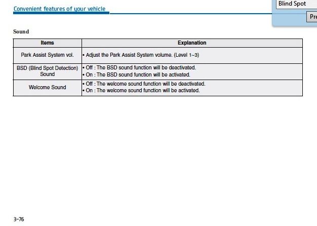

Mine has been false free so far. What is irritating though is the volume level of the warning. I know you can adjust the NAV voice but is there a way to lower the warning buzzer? Even if you're expecting it the sound of the warning will make your heart skip a beat.
In the small screen where the gages are, you can control the sound of the Blind Spot system. You can either have the sound on or you can turn it off.
Thanks for reminding me to try the obvious first. How easy it is to forget that these things come with a book :rolleyes:.
