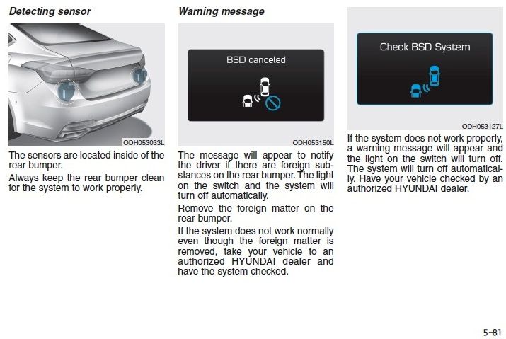

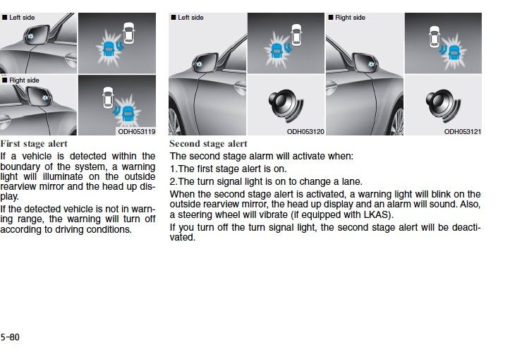

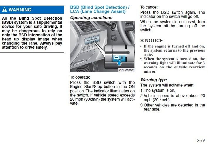

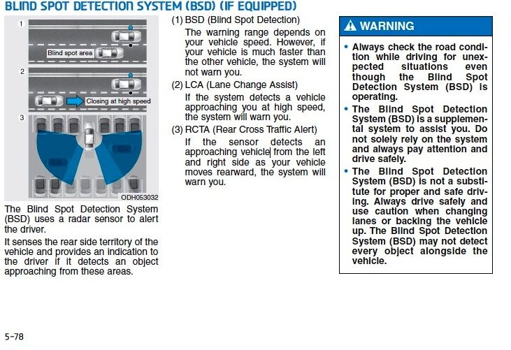

Here is the info from the manual. It does state that it is based on speed. See first pic below from manual.
