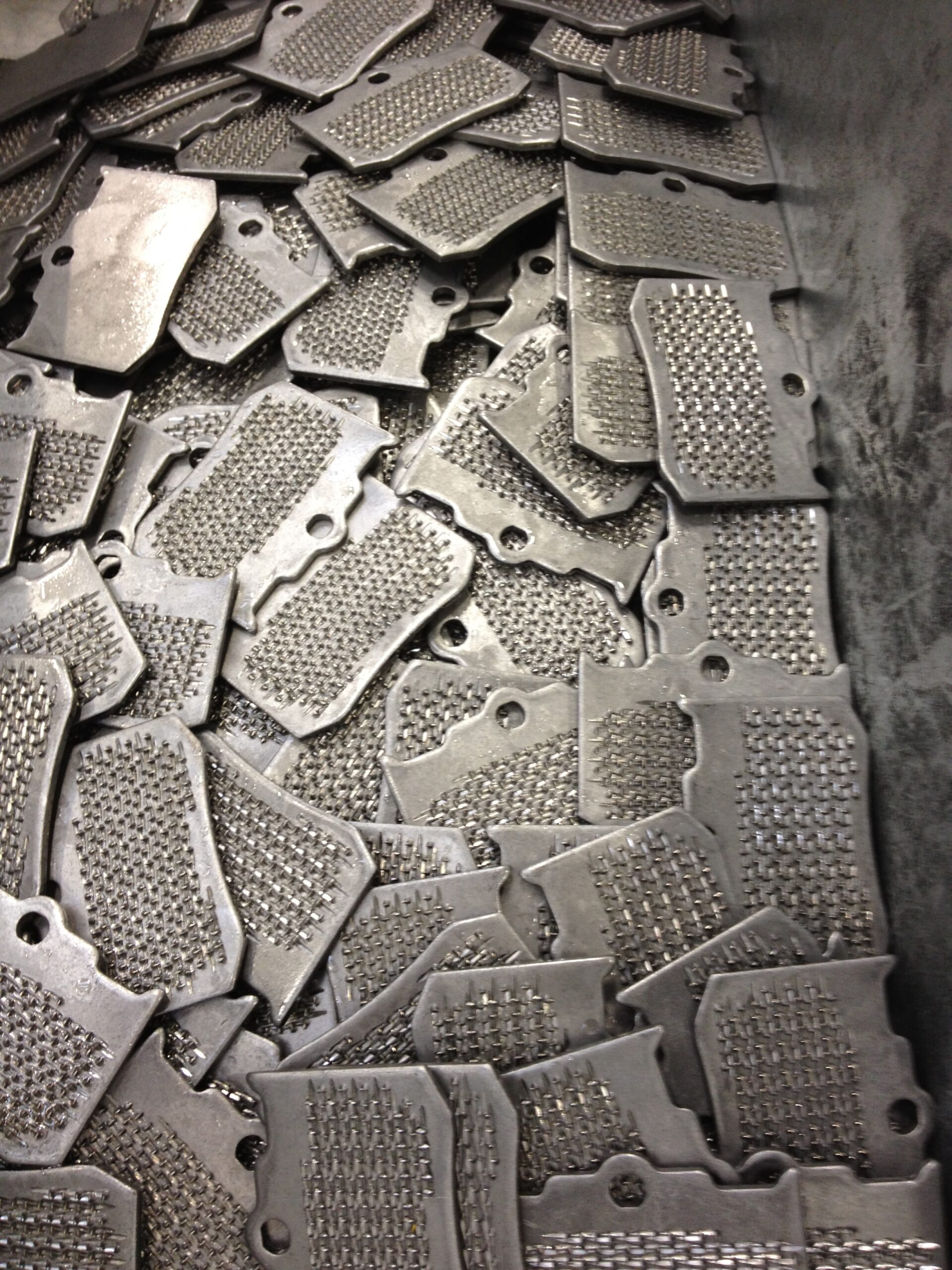

EBC brakes recognised this problem a decade ago and made two rapid-fire changes to its pads to prevent this. The first change was to include alkaline anti-corrosion additives into the pad mixes which drastically reduced interlayer corrosion. Back in 2011 EBC built its own pressworks at its Northampton HQ and installed two massive presses to apply the patented Nucap Canada NRS system to its backing plates. At a cost of over a million pounds, this was no small step for safety purposes and added significant costs to the price of the product but any and all pad debond failures completely went away. EBC backing plates for all its organic motorcycle and automotive pads are now made this way for many years.
This is what an NRS backing plate looks like.
