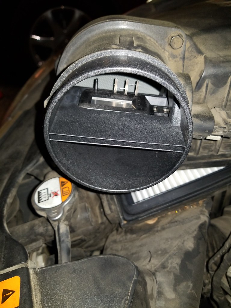

Okay, so I looked at the MAF sensor, which looks to me about like it did when it rolled off the assembly line. I can see no dirt or debris at all.
https://flic.kr/p/24WXW4x]MAF[/url] by https://www.flickr.com/photos/67568395@N04/]MDTshots[/url], on Flickr

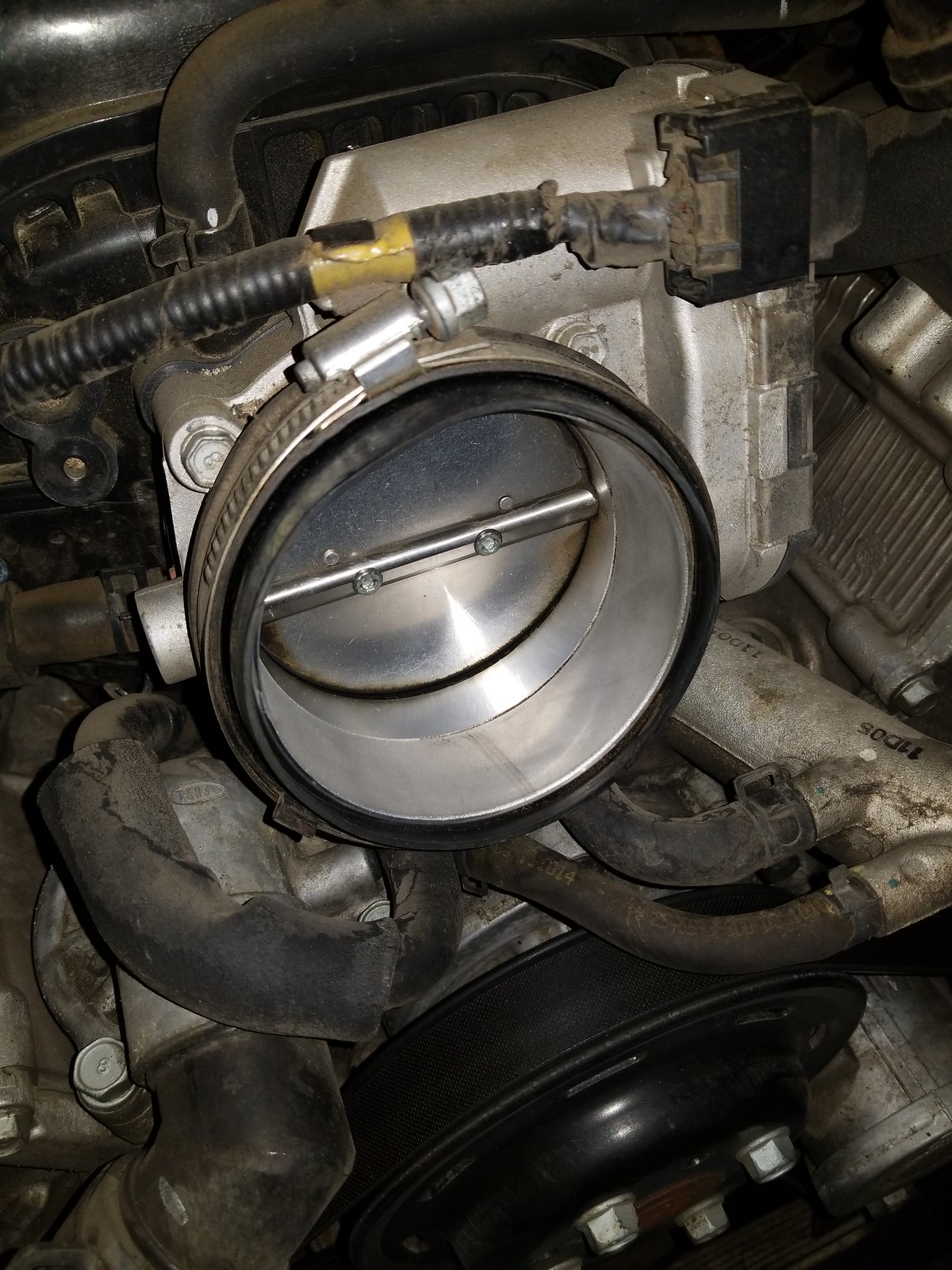

I also took a picture of the intake, which also appears quite clean to me.
https://flic.kr/p/2ftU6vE]Intake[/url] by https://www.flickr.com/photos/67568395@N04/]MDTshots[/url], on Flickr

The throttle plate looks pretty dirty in the most critical location, along the edges where it meets the housing. I would hold open the plate and give it a good cleaning with some spray and a tooth brush. Hard to tell if the MAF is dirty because the wires are out of focus in the picture. Did you end up cleaning anything or did you just put it back together?
Thanks, I couldn't get the camera to focus on those wires in the MAF, but they did look pristine. I did blow out the area with compressed air and softly wiped with a soft cloth that recessed area that looks like glass as well.
As to the throttle plate, I did see the dirt around the edges as you describe. I tried pushing lightly on the plate, but it did not move. I did not want to push very hard, as I don't know much about it and whether pushing hard might damage something. How hard can I push on that plate? It looks like it is hinged -- is that correct? Also, with what spray would you recommend I clean the plate area?

cleaned the throttle body by pressing the throttle down with the car’s accessories on and engine OFF. This is an electronic throttle body! Don’t you dare push on it!!!! You will break the teeth of the gears inside!!!!!!!! It will only move if you press the throttle down!!!!!!!!!!!!!! It’s a two man job to make it easy to clean. Don’t use a brick on the gas petal to do it yourself. It Just doesn’t work.
How is it that the throttle would open with someone's foot on the pedal but not a brick?
Also you wont hurt the throttle body by opening it by hand. I cleaned mine with the ignition completely off and just unplugging it and unbolting it from the intake so I could clean both sides. I moved the throttle blade several times to get everything good and clean both on the blade itself and the housing. That was ~1000 miles ago and it didnt cause a single issue. I do agree to not move the throttle blade with accessories/ignition on as then the ECM is controlling the throttle, unplugging it is a extra step just to be a little safer.
The Brick was a joke, sure you could find a good brick and hold it open. Me? I couldn’t find that brick.
Yeah you can push it open all day long if it’s unplugged!
It’s basic maintenance for me, just give it a wipe when you’re doing a service. Saves a lot of time when you have more cars to go and so few hours in the day.
