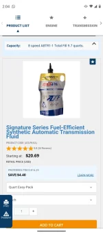

You will need about 8 quarts of this fluid type; OEM or aftermarket.

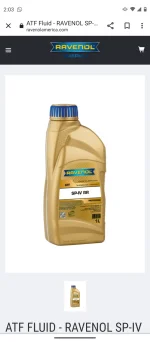

I used Revanol brand SP-IV RR transmission fluid that is made in Germany with my AST fluid pump to quickly fill the transmission pan.
I was under the expression that I would need about 7 quarts to fill the pan properly, but only about 3 1/4 quarts of fluid drained out of the transmission pan. Therefore, I just replaced the amount of fluid that drained out since my transmission was shifting well, so it appears to be filled correctly in that regard. Therefore, no need to waste good fluid out the level check plug.The transmission pan in my 5.0 seems to hold only about 3 1/2 quarts anyway since the fluid just flows out the fill hole when I tried to add more.
