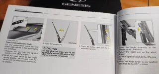

1. Before shutting off engine move wiper switch on the lever into single wiping position (MIST) position.
2. Turn off engine.
3. Push lever upward and hold it until wipers swing into upright position on the windshield.
I also attached picture of the page from the manual.

I think what AS007 is sharing is "logic", vehicle off and hold the wiper arm on the column in the "Mist" setting and the wiper arms will rise. Mine always stow when I shut the vehicle down as well.

You guys got it little bit wrong.
1. While engine is running put the lever into MIST (intermittent) position (one click down). Lever clicks and stays there, no need to hold the lever.
2. Keep the lever in MIST position and turn engine off.
3. Push lever all the way up to a stop and hold it until wipers swing into upright position.
4. Release the lever.
That's it.

The manual picture has the arrow in the "up" position. Will now have to try this.
@jep604
I just re-read the manual and I think I am the one that confused you guys and I apologize for that. I mixed up MIST and Intermittent positions.
MIST - you push lever UP to a stop and release it and lever goes back to the OFF position (MIST position is not fixed) and wipers do a single swing.
Intermittent - you push lever down one click and lever stays there (fixed position) and then you adjust interval of the swing with the ring on the lever.
And after re-reading that page in the manual I think you just need to do two things:
1. Turn off the engine
2. Push lever up into MIST position and hold it until wipers swing into upright position (service position) and stop there, and then let the lever go to the off position.
And I think you don't need to put lever into Intermittent position like I was doing to put wipers into service position.

No worries and will def try it. Thank you.
