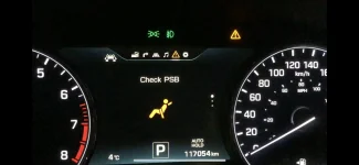

Hi everybody, Last night I was driving my 5.0 ultimate and I got blinking alarm with beeps in the gauge cluster telling me Check PSB. I scanned the car and is giving me Trouble code U0109 Lost Communication With Fuel Pump Control Module "A"
Has anybody had a same problem? any idea about the cause or repair would be appreciated.
I attached the OBD2 report to the thread.

Coincidence... or are the electronics in these cars just a mess? Why would a check Pre-Safe Seat Belt warning message appear for a issue with a fuel pump? This is not the first post about a fuel pump module causing weirdness on the CAN bus.
it's the module that controls the psb and fuel pump, I had mine replaced 2 years ago and the error has never come back.

Thanks for the information. Do you remember how long did the service take?
My dealer replaced the module in about 4 hours, and I didn’t even have an appointment. I’m still in shock about how fast that was diagnosed and solved. It took me almost as long to rent a car and get back to my office.
Good to know about the timing. My 2015 3.8 Genesis is going through this same issue- PSB Warning light. I have a service appointment tomorrow at 7:30am and have printed this thread to show them. Hope this works...fingers crossed!

Not so weird... When my Infiniti was losing a cam position sensor, it lit up the traction/stability control lights as well as Check Engine.
I got the same issue (PSB) alarm the agent did the same solution which they have replaced the controller of fuel pump. However, I have noticed they have used a different part number the old was 33040-B1000 and the new 33041-D2000
