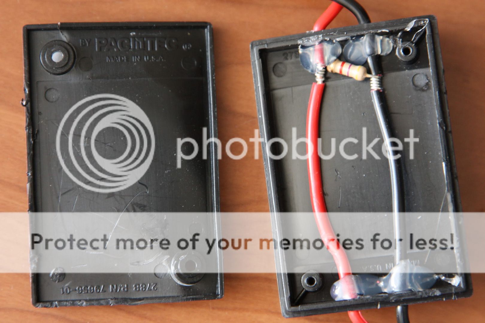

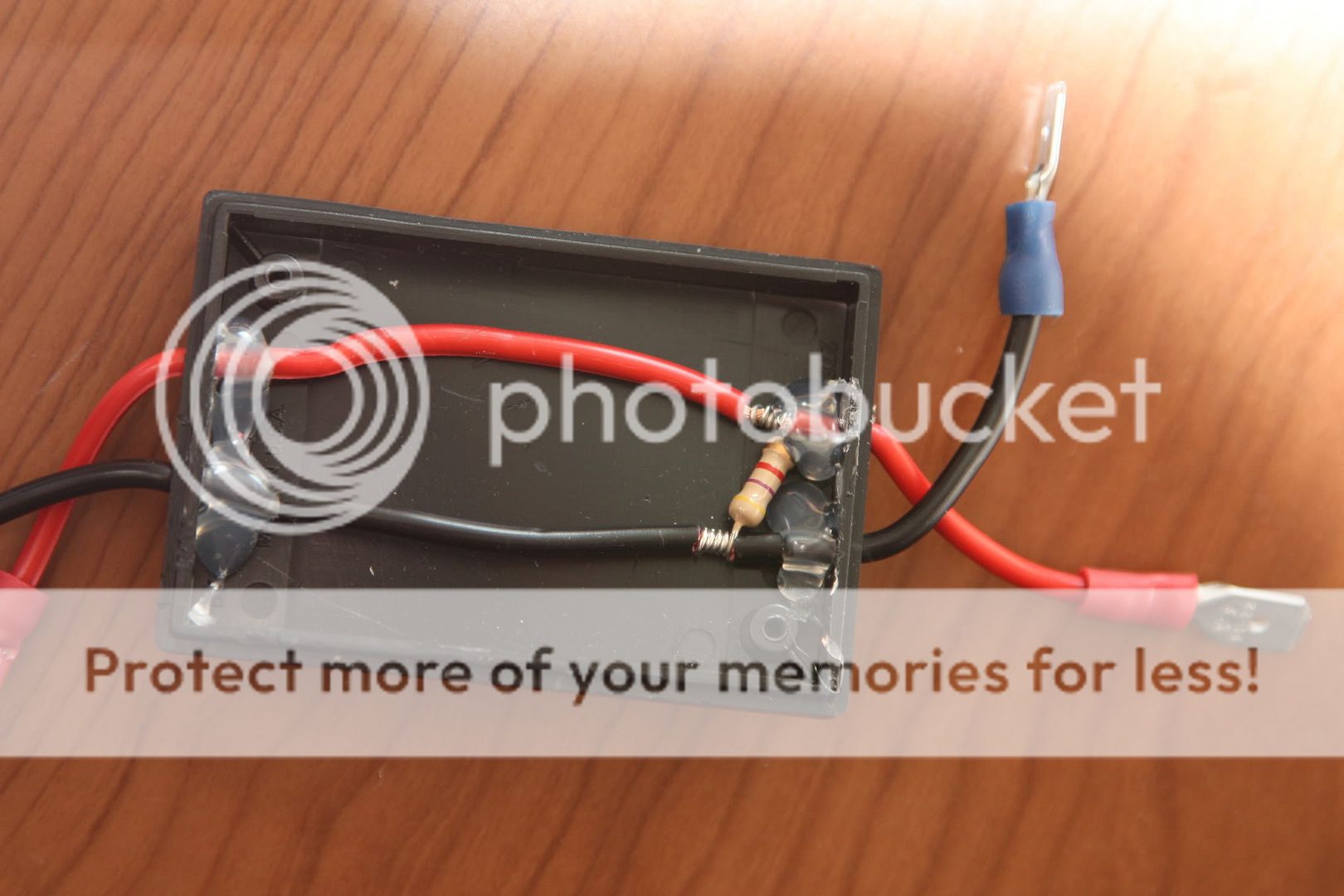

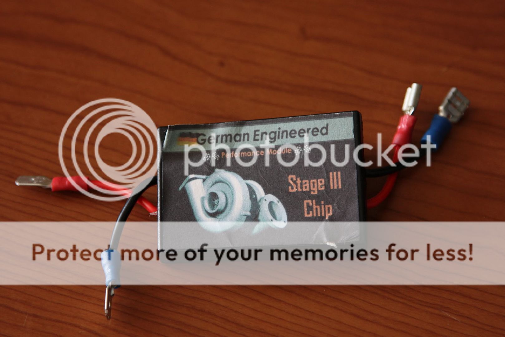

chips are a fun subject. One day I was bored and decided to buy one for the specific purpose of taking it apart.
use at your own risk :)
100 bucks? Guess there is $99.75 in profit
Agreed 1000% these cheap no name performance chips and even handhelds for the most part do absolutely nothing or dont do alot since they are generic tunes. One genesis to the next is going to be a totally different monster and a generic tune may work ok on one and absolutely suck on another car. Spend your money on having someone do a real custom pcm/tcm tune. Also as illustrated above, many of the "chips" have nothing more than resistors in a box doing god knows what to your car. Coming from the chevy LS motor world handheld programmers and "chips" are no no's and will get you laughed at for the most part. Even doing mods like intake and exhaust are non productive without tuning specifically for it.
