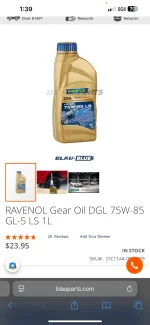

This is what I used. 3 liter bottles was perfect for both the front and rear differentials. You’ll need a 24mm socket with a breaker bar, a 10 mm Allen key and about 30 min to do both. On the front removed the tire and a little access panel for ease.
So a total of 3 liters did both diffs? And they charged me for 3 liters for just the rear. Scam.
Yup
