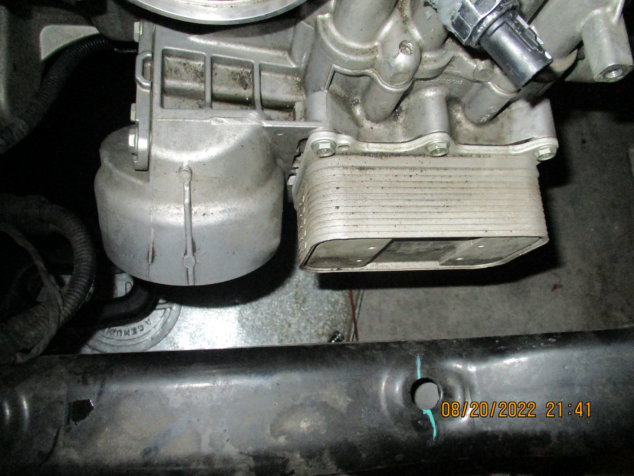

Note: The engine oil cooler on the 5.0 do not have any hoses attached to it. The oil cooler is secured to the lower front timing cover with a gasket and bolts.
