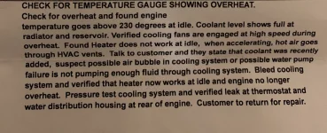

I have a 2009 Hyundai Genesis 3.8 V6 with a small coolant leak that’s causing air to come in the system and spikes my temp gauge.
Had it seen by my shop and said they located leak by thermostat and water distribution housing at the rear or engine (diagnosis picture attached). He explained the leak is where the tube and the port meet.
So they wanted to charge me $800 to fix it that from what I understand is replacing a full assembly.
That’s 1/3 of the current value of my car lol so I opted out, for now.
