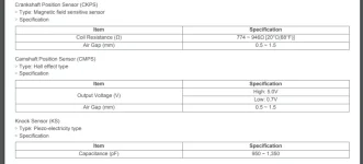

Hello all,
I am wondering what the ohms should be for a crank position sensor for my 2012 3.8. I'm getting a reading around 575 on the multimeter.
Thanks.
From the 2012 4.6 manual:
