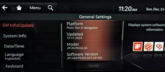

Is this the most up to date software version? JX1_22.USA.P6.001.006.230628
2024 GV80
Thanks!
+|23Q2|JX1_22.USA.P6.001.007.231101|GN|2023_GV80_USA|1512|1
Anyone have an update file? I have the xx. 006.230628 for Genesis gv80 but it doesn't seem to work with android auto wireless. The site is down for downloads, so hop someone in the community can share their file please

I tried to install the new update and it seems not to be recognized by the car's system. I have previously installed all the prior updates since 2021 without an issue, but this time nothing happened when I plugged in the USB key. I'm wondering if there was a glitch in my download or whether the last update which installed wireless CarPlay has somehow affected how the car reads the drive. I'll try downloading another copy and see what happens and report.
OK, I went out to my car to see if I could update it with the usb drive.
I plugged the drive in and it said it did not recognize the files on the drive or something like that.
I then went into the SW update section of the setting and found that there was an update for the radio that needed to be finalized.
So I told it to do that and when back into the house for about 5 minutes.
When I came back out the system was rebooting (I left the engine running)
When it finished booting up. it told me the system had been updated with the map version JX1.........251114 October 2025.
So I am thinking two things.
1 That I must have gotten the OTA update but it never fully installed because I did not know it was there and I never finalized it.
2 Because the update was already in my my system, the system rejected the files on the usb drive I tried to use. (This one is a guess)
So if you have not already done so, try going to the software update in the general settings and see if anything is there.
Good luck.
OK, I just got a email from Genesis telling me the scheduled OTA update was completed.....So I guess it did come over the air. I wonder how long it had been downloaded waiting for me to install it?
