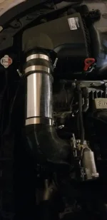

Just a test setup with parts in the garage. Will build something more permanent once I'm happy with the results. Still need to pick up a K&N high flow filter.
3.5 to 4" elbow then 4" tubing/coupler to airbox.

NSXNEXT is the inlet for the air box 4" ? I noticed the clamp on the airbox seem to have reduced the coupler size that you have in the image by about .25" to .5". I was looking at doing this same intake setup as well. I just got my exhaust done custom 2.5" (MSA Style) x pipe and gutted secondary cats.

Looks nice, but I would recommend either wrapping that intake tube with heat reflecting foil or some sort of heat resistant coating. Metal piping heat-soaks pretty quick when there isn't adequate under hood airflow.
