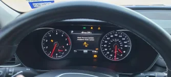

My wife was driving my 2019 G70. When she started it up, she got a dashboad full of warning lights (see attached photo). She sent me the photo and drove on.
Once she stopped and restarted the car it was normal.
Anyone have this happen? Any idea what it may be other than an electrical glitch?

That will store fault codes. Check the vehicle diagnostics on the mygenensis website for your car. Print out or show the codes to the dealer. Same thing exact thing happened to me. The dash lit up first time and I restarted the car and it went away for a month or so then it came back with vengeance. Based on that photo it looks like it could be some sort of wheel speed sensor. All of the safety tech and traction control systems need accurate speed info and if one sensor intermittently fails all the lights will come on just like you have in the photo. Should be an easy warranty fix, may get delayed though due to part shipping. I just got my car from the dealer after 2 weeks waiting for the part for this exact same issue. I also have a 2019 G70 for reference and see attached image for the part that was the culprit causing this.
