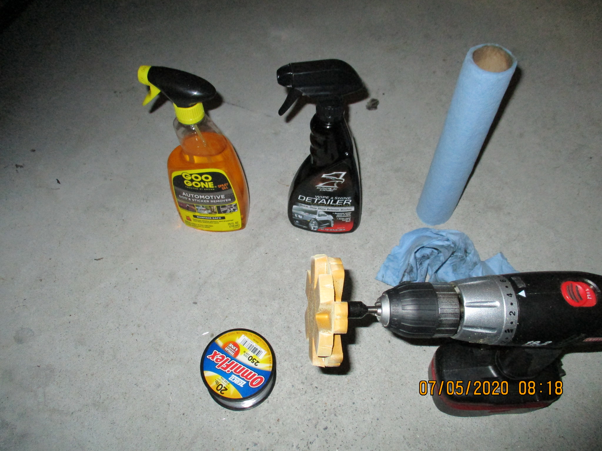

I use 20lb fishing line to de-badge my cars. I also recommend using a rubber decal eraser wheel attached to a drill to remove any hard to remove adhesive residue remaining on the body to minimize scratching. That is the methods I used to de-badge my Escalade side badges recently. The rubber wheel costs about $15 on Amazon.

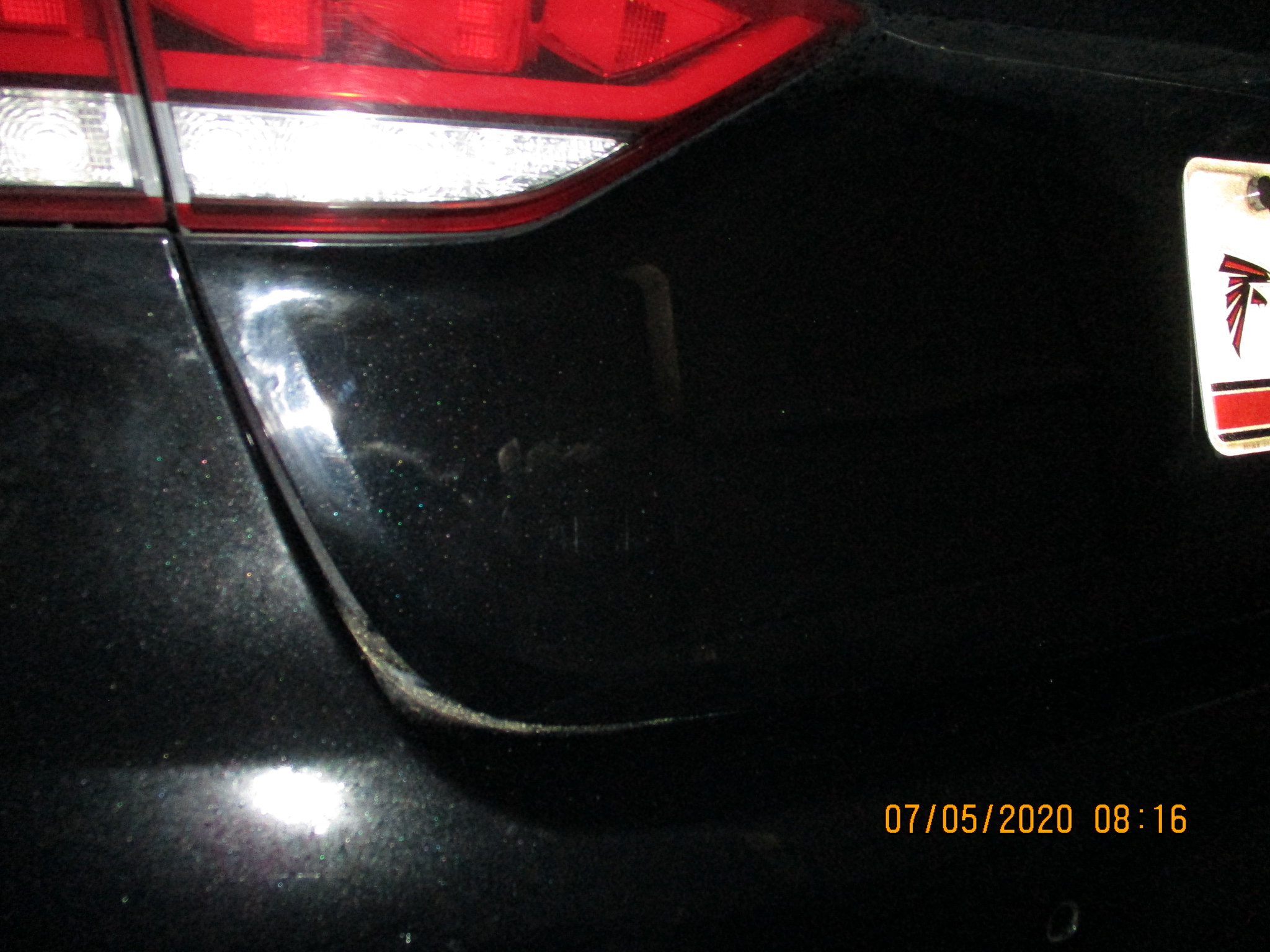

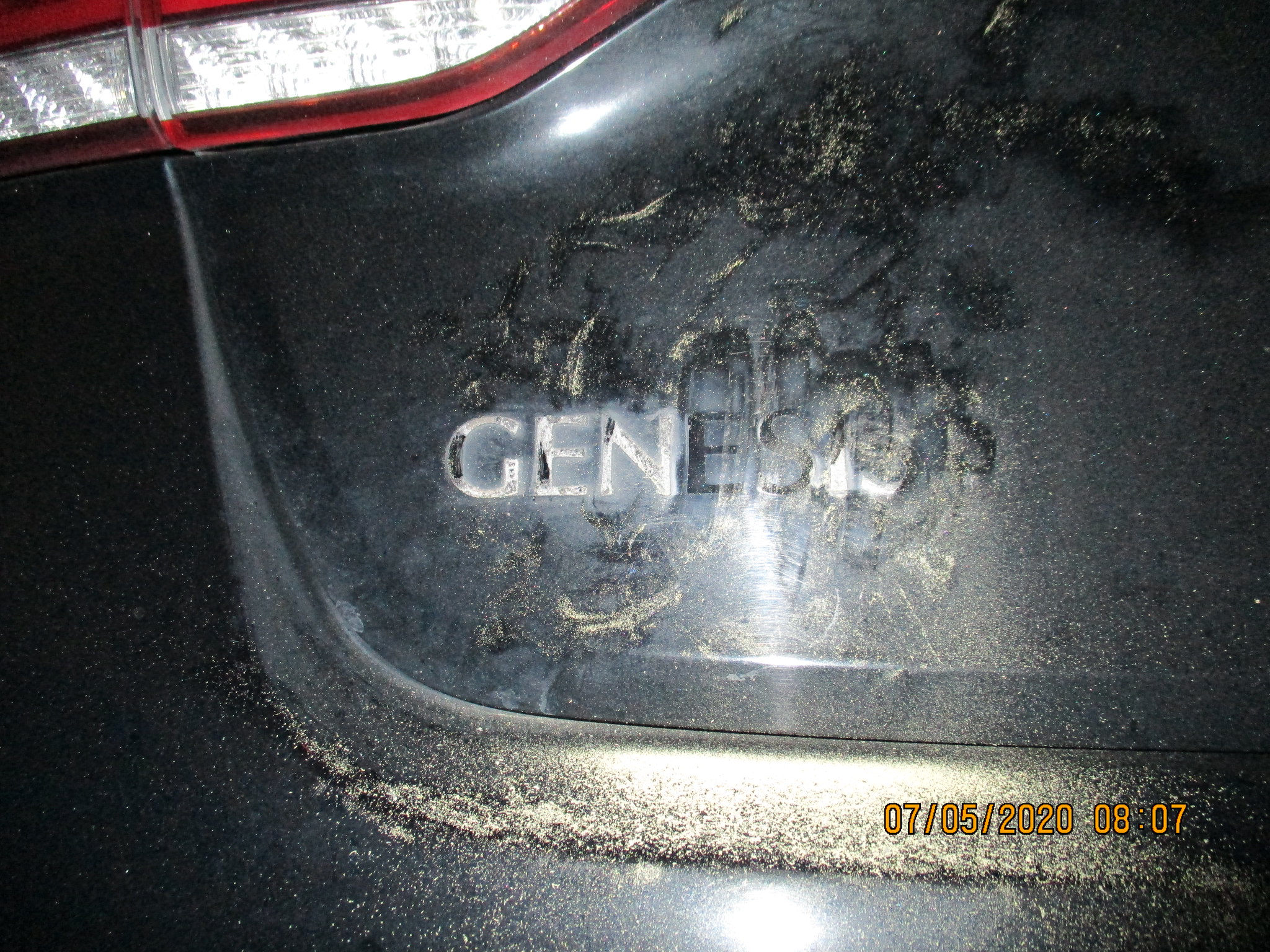

Today I removed the rear Genesis badge on my 2015 5.0. I used 20lb fishing line and the rubber eraser method I described above in post #4. The process took about 10 minutes(maybe less) tops including using adhesive remover and paint detailer to clean up the site.
The process worked without scratching the paint.
Tip: If you use fishing line to debadge keep the line close to the back of the badge you are removing so that you only touch the badge and not the body paint while you use a sawing motion. No scratches.

Body after the tape residue was removed and the area cleaned.
The products I used.
