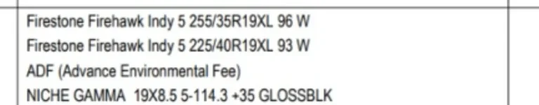

Currently own a 3.3t AWD G70 and recently bought new rims and tires. I might be a dumb teenager but recently noticed stutters when making low speed turns and was wondering if my tire/rim setup has something to do with it...
Heres the setup:
Feel free to be brutally honest and if anyone can drop some suggestions please do!
Should be just fine, something else during the install may be coming into play, but the tire & wheel specs look just fine, they did put the wider tires in back correct?
Yeah they did put the wider ones in the back. I just recently saw someone say 19 inch rims will cause vibrations when driving at high speeds. Of course there also could be numerous other reasons for that. Already booked a diagnosis at Hyundai (dont have a stand alone Genesis Dealership near me).
If the wheels/tires weren't road force balanced I would have them do that or find a shop that has one. 19" wheel/tire setup shouldn't have any problems assuming the tires and wheels are running true. Might have had some wheel weights fall off or a tire technician that messed up, it happens.
This kinda makes me think it has something to do with your AWD not liking the new tire/wheel sizing. The numbers look okay, but you just never know. If the effective rolling diameter between front and rear vary too much, the AWD won't like it and will make noise.
