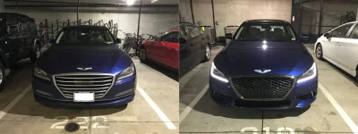

Before and after:
Note that if you really want to finish the Sport look, you'd be looking at replacing the headlights, and the other chrome trim parts which are tinted on the Sport. And of course, the wheels. Those are next for me ;)
