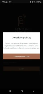

Now that I have my vehicle back, I am trying to finish getting things set up and am running into issues with the digital Key. I downloaded the app, but get an error about it needing to be activated. I can't find anywhere to do an activation though or find anywhere online talking about it.

I gwt the same thing. I have had my 2023 GV80 sine 20 May. We may need to wait for our physical digital key. Not really sure. Let me know if you find out anything.

There is no physical part to the digital key. Has your Dealer done his part to record your email when you bought the car?

I understand how the app works. Just not sure why I cannot get the digital key to work yet. I already have a ticket in on this, but I will be calling Genesis again since it has been a while. I will also check with my dealer about registration.

I have exchanged a few emails with Genesis and I think we are finally (or at least I am hoping) to the point where they are understanding the problem. I got them to tell me exactly where on mygenesis the digital Key stuff should be, and it is not there. Waiting to hear back and will update when I do.

I have had a similar exchange with Genesis and have same issue (no such option in my mygenesis account to enable the Digital Key). Have you gotten actual resolution?

No! At this point, support seems to be ignoring me.. The last exchange I had with them, I got an update to the ticket saying they had tried calling me but could not reach me and that I needed to call in due to the nature of the ticket, but I had no missed calls. I called in and the guy tried walking me through setup but when i stopped him and said there is no digital key section within account of mygenesis he said he couldn't help me and the original person working my ticket would be in touch. I asked for an update earlier this week and have not gotten one.
I got a call from Genesis Customer Care regarding the digital key. I too cannot setup the digital key. It keeps telling me to log in and then says there is no user account and set one up. The agent had me check the website for the activation of the digital key to verify that it was missing. They then had me take a screenshot of the page to send to them. She said it was going to the engineers and she acknowledged that there is an issue with the site and the engineers are working on it. So at least they are aware now.

OK, so what is your point for posting this? I do have an android phone and it is on Android 12. BLE is no issue. The issue is the Genesis site.
Did you activate the digital key option on your account? Genesis Owners Homepage | MyGenesis
After you login, the options "burger" on top right should open a right side panel. You should see your car, choose option "Manage Vehicles." Then go to Data & Privacy tab, there you will find "Genesis Digital Key" toggle option. Enabling that should allow you to login into the Digital Key app, set up your phone with your car, etc. I highly recommend to disable all adblockers during this, the Genesis website is terrible and will break because of it. I had a lot of issues due to my DNS sinkhole (another adblocker system).
