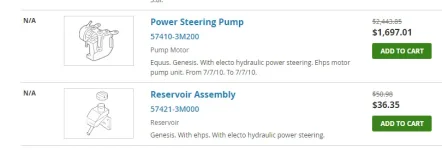

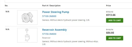

Hello, What year is your car?
Just FYI - The non-EHPS models have a round reservoir, and use PSF-4. My 2011 v6 has non-EHPS
