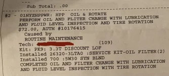

My work order doesn't say exactly what they used, but the oil sticker they placed on my windshield said "quaker state". No idea if that's what they used or not. Apparently according to the manual it's supposed to be full synthetic, and if blend is used then I must change oil according to severe conditions, I gotta say I'm pretty pissed and disappointed, I literally bought my car from them and this is how they treat me. I would rather pay out of pocket next time for full synthetic.

^yup, i am not aware of any non-synthetic oil that matches the OE spec, which is why the OM stipulates full synthetic is required. Just wasn’t sure if this was also the case in the US - but that is confirmed.
Seems cut and dried: anything other than full synthetic matching OE specs does not comply with the Genesis OM.
