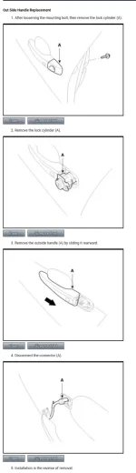

Driver proximity sensor on the handle not responding but passenger works fine. Any quick fixes you guys know about.
If using the fob or the button inside and the door locks/unlocks as normal, I'd think the handle button may be the problem. If it does not work with the other controls, I'd think the actuator.
......I had the same problem where only my passenger side door handle would work....found the part # for my 2009 4.6 Genesis and was lucky to find someone online selling a brand new exterior door handle in my color code for my car..... Its simple to replace and brought a smile back to my face once i replaced it myself...... Just google your year make & model of geneis and exterior door handle.........DO NOT GO TO THE DEALER !!!!! lol
.......Here you go...
Aha cool thanks you happen to have that part number? It must be the handle everything else is currently operational...🤞🏼
......dont have the part # just Google Hyundia Genesis Drivers Side Door Handle & see what comes up , check on Amazon and EBay.....which is where I got mines from
