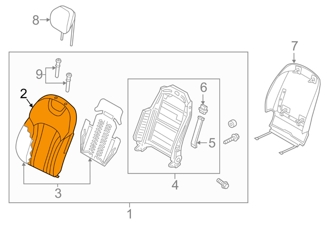

Here is the schematic of the drivers back;
There are hook clips on the bottom and push in clip on the top. I would imagine the top push clips either not fully engaged or broken off. Please do take it to the dealer and let them replace it. They aren't inexpensive at $427.00 a piece.

Let me guess. Part #7 in the diagram, and the clips themselves are not available separately?

I have had this happen to me. The plastic tabs on part #7 were broken right off. There are two metal pieces that slide under those plastic tabs and push into the frame of the seat. That is how the entire back piece is attached to the seat.
I went to the dealer and they asked for $850 for part #7. I said screw that. I fixed it myself by drilling two small holes on the broken tab housings. Put a zip-tie thru the hole and around the metal pieces and tightened. Lined up the metal pieces with the locations on the frame of the seat and pushed them in. It has been a SOLID fix for a while now.
If you need to access the internals of your seat, I don't see how you access them without breaking those plastic tabs. Seems like a design flaw.
