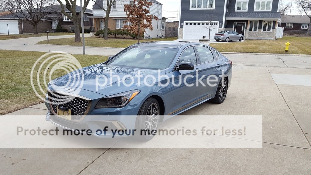

Well I finally brought in my 2016 for the Flutter issue along with the Pano roof noise, shifting drivers seat, vibration, random loss of sound and to have them program my Card Key. Don't think they were very happy to see me again after all the issues I had with my Sonata but the dealer was very friendly and made a complete list of every issue or annoyance that I have had with the car and then put me in a 2018 3.3T Sport which I wasn't expecting. Ill update the other threads for the flutter, roof and card key once they address these issues. But so far they didn't seem to doubt or question any of my issues like I had in the past with the Sonata. I also offered them videos of the issues just incase they couldn't replicate them and they declined and even stated that it may take a while to order a replacement pano roof unlike my Sonata where they tried to repair it multiple times before just replacing it. I must say though that my drive to work in the 3.3T Sport was nice! Don't really care for the interior of the car but wow this thing takes off like a rocket vs my 3.8. Suspension is definitely a lot stiffer and the cabin seems a bit louder than my 3.8 but the power is where these cars should be. Hope to hear it's going to take a few days to fix!
