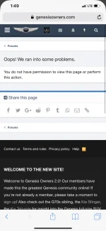

I don't think there are any rules on PMing, just click on the member's name and choose Start Conversation. Although in this case we would like to hear if there was an outcome. ;)
For some reason it says I don’t have permission when doing so.
