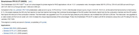

I don't think you're correct about this on the new 3.5T engine.
Well yea. I'm not talking about the 3.5. That is not a DI engine...it has dual fuel injection (DI and port injection).
The 3.5 isn't available on the G70. OP has a G70. This is the G70 sub-forum. Fuel quality has no effect on the carbon buildup for our cars.

I did find this on Google
Is Shell gas better than Chevron?
Chevron has Techron and puts in ever gallon and every grade. Shell has V- Power Nitro + but they only put it in Premium.
Good points here. Using a top tier gas certainly doesn’t hurt anything on our DI engines. The cleaning agents also keep tops of pistons clean, or cleaner than non detergent fuels do. What’s going on at the backs of my valves, not so sure other than my oil catch cans should be at least helping there. I usually get 89 octane top tier vs 93. I’m cheap and can deal with the $.25 or $.30 extra cost for 89 octane but not the $.60 to $1.00 more for 93 octane that’s not really needed to begin with unless your track racing or really need top performance in hot weather.
With DI fuel never touches the back of the valves to clean them off, so the quality of fuel won't have any effect on the carbon buildup.
Ahhh, thanks for the correction. I thought that it did.
So, for a straight DI engine, it only helps with combustion chamber and injectors, but has no impact on the top side of the valves.
Mine is a GV80 so it will help with all three areas, but in your vehicle top tier helps less.
