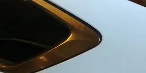

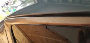

20180827_191058.jpg I have my G80 sport for about 3 months and after I got my car back from the dealership for some rattle and armrest fabric issue. I notice that the dark chrome trim around the doors starting to discolor. I see spots everywhere on the chrome. Pieces started to look like it was from a 15 year old car.
Is anyone is having this issue? This is a WTF moment.

Have there been any attempts to remove or polish the discolorations? Is it possible that it’s just residue from cleaners used in the shop’s car wash?

I had this exact same issue. It was most prevalent on the driver side trim. In my case the it could not be buffed out. The lighter color spots was where the darker color (lacquer ???) was missing. The existing/remaining "lacquer" coating would have to be buffed out resulting in a lighter color trim. The large round lighter area in the attached picture is where I attempted to buff this out.
I suspect this existed at delivery, but didn't notice it until I washed car for the first time 2 weeks later. I took it back to dealer and they replaced the trim on ALL 4 side windows at no cost (covered under warranty). One piece of the new/replacement trim had a similar minor imperfection that I accepted. Estimated cost if I had to pay was $800USD.
My hypothesis is car is shipped with plastic protective film on this trim. When this film is removed by the dealer the "lacquer" is being removed/damaged. IMO this would be a defect in the darkening process/lacquer or the protective film (too sticky). The dealer service department indicated having seen a few other 2018 G80s with the same issue.

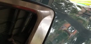

Same problem here. When I took delivery of my G80 Sport all the window trim on the right side had what appeared to be water spots. Brought to dealer's attention as I was inspecting the car at delivery. They took it to the body shop and attempted to remove the spots to no avail. They ordered new trim on the spot and it was installed 2 weeks later. No issues since. I took delivery on the car 03/29/18 and the build date 05/29/17. The dealer and I both suspect the spotting and discoloration occurred in transit or at the port. Possibly something corrosive.
I originally suspected damage was caused in transit or at port, but one of the REPLACEMENT trim parts had similar etching; albeit considerably less.
The damage does appear to be from a corrosive chemical (acid/base i.e. muriatic acid, ammonia, etc.).

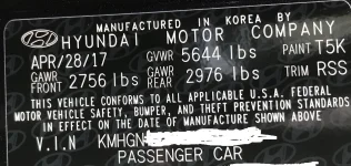

I have a picture, in hand right now, of a label from the car with VIN. It shows MFD IN 01/08. I'm not sure how to interpret that date (Manufactured Jan 8, 2017 ????).
The sticker on the driver side door panel should show a full day, month, year MFD. Mine shows 05/29/17 as an example.
My car came through the port of Brunswick GA. It could be that the manufacturing process is flawed or the finish has been damaged by some outside agent. It is covered under warranty and if you still have damage I would ask for a second replacement.

I'll chase down shipping date and port of entry when I can. I have a picture, in hand right now, of a label from the car with VIN. It shows MFD IN 01/08. I'm not sure how to interpret that date (Manufactured Jan 8, 2017 ????). I recall the Dealer "window sticker", which I have somewhere, had port of entry name (most likely "Baaaaaawtimore, MD" :cool:) and date on it.
The sticker on the drivers door indicates manufacturer date was April 28, 2017

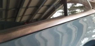

Just had my window trim replaced under warranty. I leased my G80 Sport when they first came out in June 2017. Never really paid attention to the trim until my wife said something. Being a rental I really didn't care that much but brought the car in the service and showed my adviser the the damaged trim. He said he never saw that before and took some pics to forward to Hyundai. Two weeks later said Hyundai approved replacement under warranty. Ordered and installed the parts and now all is good.
P.S. Your pictures look exactly like my car did.

I am having the same issue now as well. Trying to work with my dealership to submit a warranty claim. I will keep you all posted when I hear back.
Essentially this is effecting all of my door trim on both sides. I was told initially it wouldn't be covered as this is environmental. This is a known issue. They did attempt to acid wash it but it only made the stains darker.
