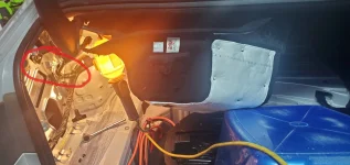

I replaced the fuel module in my car and it runs better than ever! It used to hesitate like it was gulping air if I stepped on the gas but now it gets up and goes!
It was in the trunk on the driver's side - I had to remove the trunk liner and liner up to the bumper
