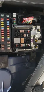

Is there any fuse missing . Can someone help with the diagram for engine fuse box
It's on the underside of the fuse box lid. Orientate it properly and you can see what fuses go to what. The other user is correct you see the + post inside the fuse box. That is your positive connection for jump starting purposes.
Also you are not missing fuses. Some of the spaces are meant be to left blank.
