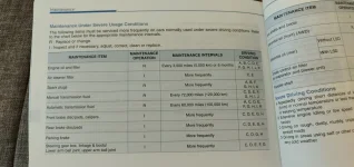

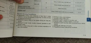

Keep in mind that Genesis recommends changing the oil every 6k miles here in the US under "normal" driving conditions... But they recommend changing the oil every 3k miles under "severe" driving conditions.
Take a look at what they consider severe - driving uphill and downhill, among other things... Haha.
19657
19658
On top of this, not every dealer uses high quality engine oil, much less synthetic. My closest dealership uses Motorcraft oil. When I asked the lady if I could use my own, she almost sounded offended, "Why? Is there something wrong with the oil we use?" I didn't have the heart to tell her that the oil they use is garbage, so I just said "Well, I just have my own preference."
That said, for some of us it is worth changing our own oil with really good stuff and more often than 6k. We also can use higher viscosity if we wish. When pushing higher power this is actually worth it.
Hyundai--if I recall, is similar. And, not changing within the time frame that they say can, I believe, void the warranty. Given the definition of "severe" not sure who would qualify for other than "severe."
