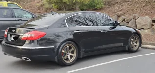

It's been good since then. Gas mileage is up.
I was trolling the forum looking at the gen coupe Bremen swap and saw this post I made and thought I'd update it.
Recently I replaced the front control arm bushings and installed coilovers from Megan. I was just going to do new shocks and struts but being dealer only they wanted 1200 just for parts and the coilovers were 750 shipped.
Rides great.
