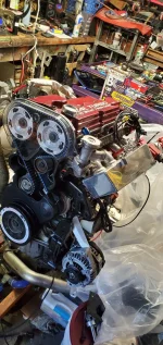

I am not your average owner im a certified tech, build plenty of cars, engines,transmission ect....own 72 dart, 70 roadrunner, srt4 in the works hoping for 800 plus ( built engine to 1200, liberty gears doggbox transmission, custom turbo manifold and turbo, jmf custom intake manifold, 80mm tb, 2200cc injectors, ect wll the work$$) A spacer by its self is not a major increase but about 5 to 10 hp and torque is seen but paired with other mods it helps
Would need to see actual numbers on a spacer before I'd buy one for that very reason- you're used to doing performance port injection systems, whereas this is a direct injection engine. The runner pressure cycles on an intake stroke don't affect fuel/air density like port injection systems where you can stuff a tiny bit more fuel mixture into the cylinder by having more air mass behind the throttle body.
And here's problem #2: You can't easily prove a 5-10HP increase. That's well within the margin of error for any Dynojet or Mustang dynamometer on any measurement above 300WHP. The 5.0 is rated for 420 at the crank, so adding 10HP (at best) there is like trying to measure a 8HP difference at the wheels. The only measurable gains the DH 5.0 has ever made were with full catback exhaust systems, which averaged 25-35HP.
