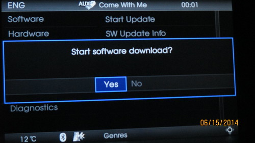

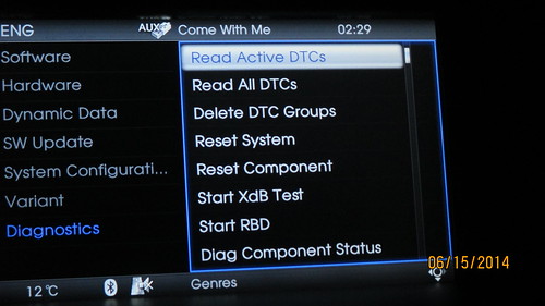

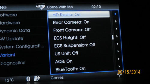

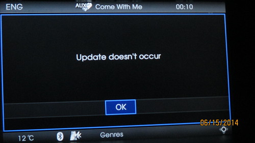

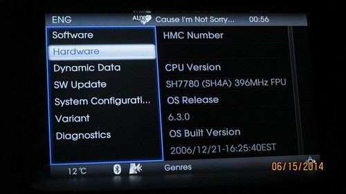

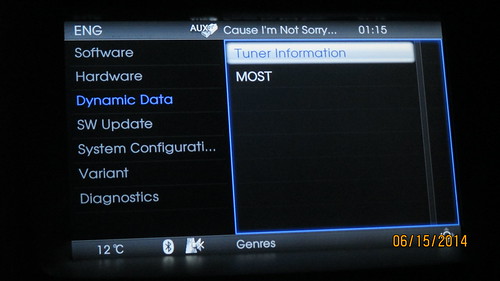

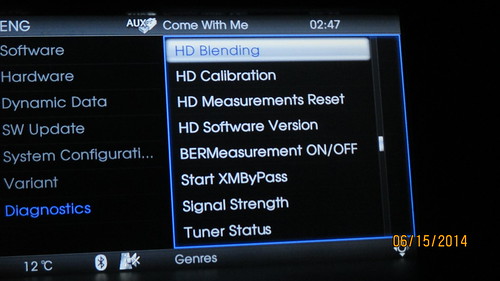

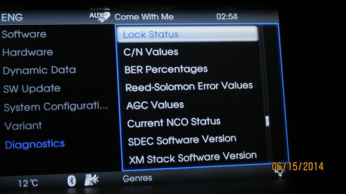

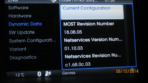

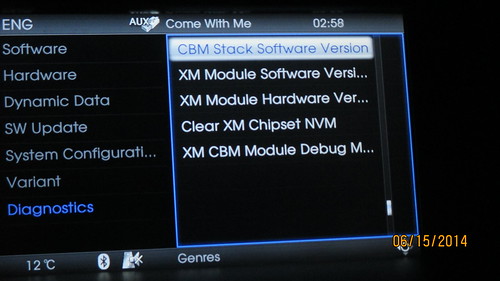

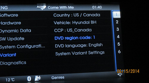

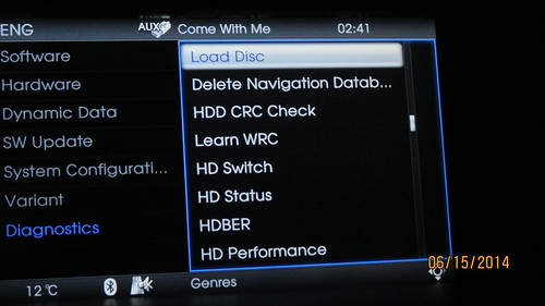

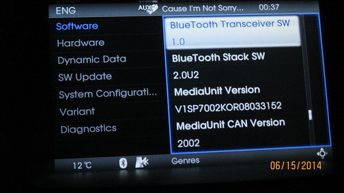

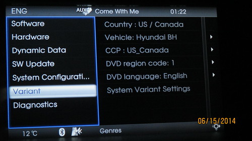

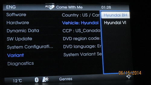

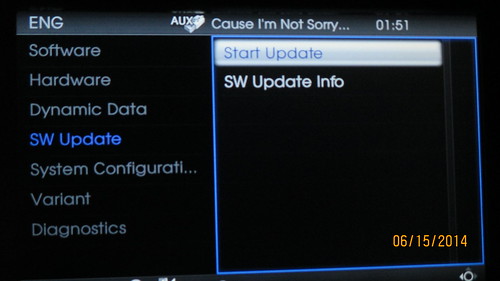

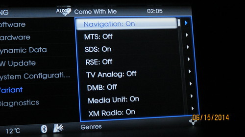

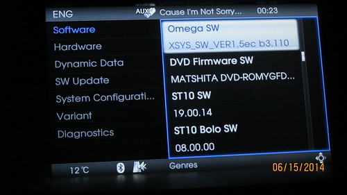

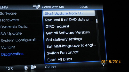

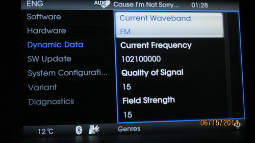

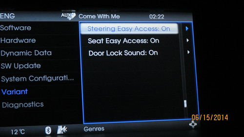

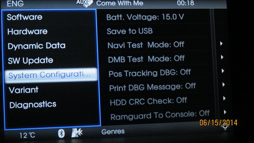

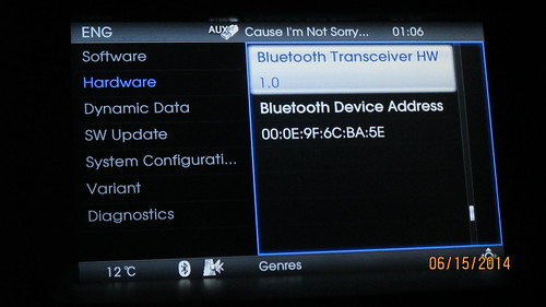

All, I own the 2009 Hyundai Genesis 4.6L/Tech Package.
**This feature has only been tested on a 2009. Please send me a PM if you've successfully accessed the menu with your Model Year 2010/2011/2012/2013/2014 Genesis.
*This guide is only applicable for models with the DIS (Driver Infotainment System).

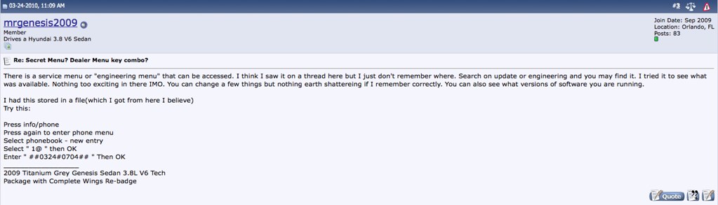

Credits go to all for finding this useful information.

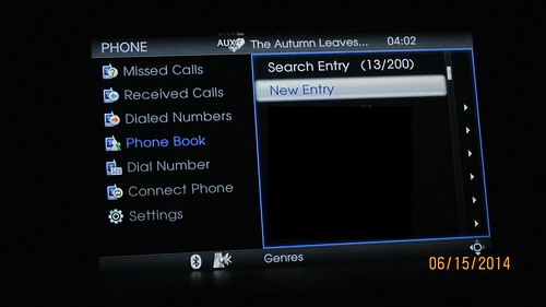

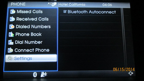

1. Get to the Phone Menu by 'Pressing Info/Phone'.
2. Select Phonebook --> New Entry

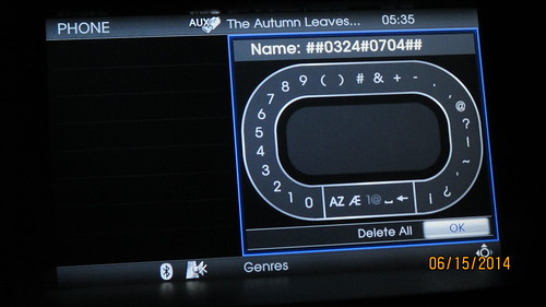

3.Enter '##0324#0704##'

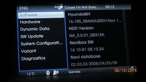

4. Press 'OK' and it will take you to the Engineering menu.
