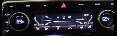

Does anyone know how to reset the system? My touchscreen for the heating/cooling system along with the heated seats, heated steering wheel, ect is frozen. I can get heat to work when I press the auto button but can't change fan speed. It's been happening the last few days. Not sure how to restart the system. Any help would be greatly appreciated.

How are you trying to change the fan speed exactly?
Do any of the other controls work?
You don’t happen to be wearing gloves do you?
Attached is a picture to try to explain the issue.
When I try touching any of the touchscreen for fan speed, heated/cooled seats, heated steering wheel, ect. Nothing happens. I am not wearing gloves. The screen just doesn't respond.

Now, the plastic buttons around the touchscreen controls do work. Because it's not happening all the time it's hard to know what is going on. I do not see a reset button like on some older models that you push with a paperclip on the GV80.

I'm not sure whether the reset method for the main screen also reboots the system for the climate controls, but it's worth a try. Hold map and set-up buttons until the screen goes blank. Reboot takes less than a minute.
