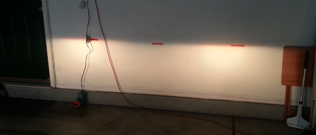

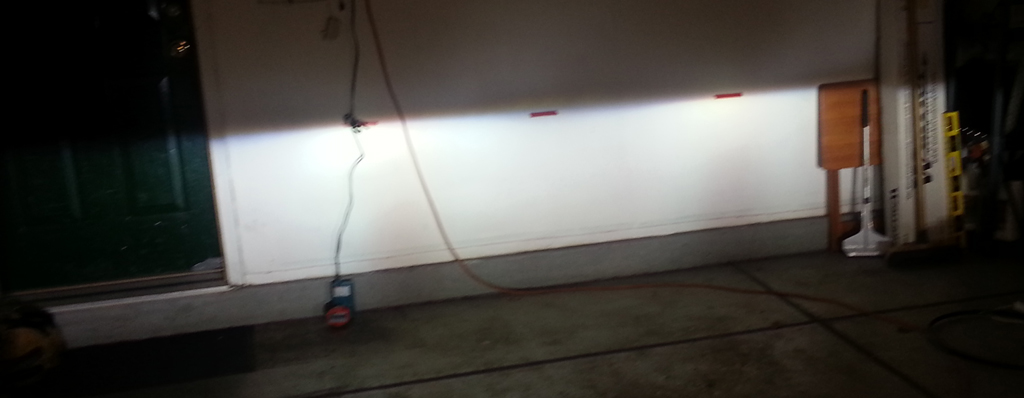

I used the Morimoto XB 35's from TRS - had to swap to the XB's because the standard had the return wire inside the bulb on the wrong side and cast a strange shadow on the ground in front of the car. You can see the shadow in the wall pix below - but once I changed them it went away and has been great. The cutoff landed almost exactly where the stocks were - and there was NO vertical light scatter at all.
Build thread link below...
Stock halogen:
After bulbs & ballasts:
