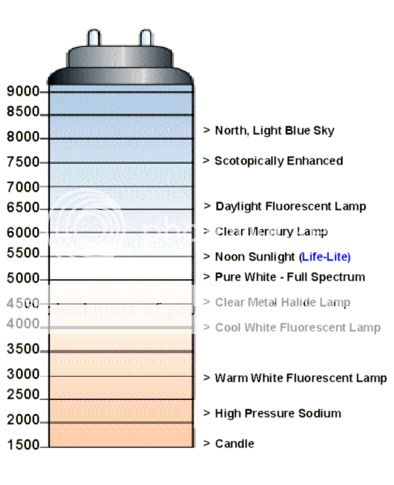

You know that switching to a 6000k bulb will diminish your light output (you wont see as far down the road)....the color output is blue.
In application, the Kelvin temperature of lamps is used to categorize them as warm, neutral or cool sources. The terms are not directly related to temperature; instead, they describe how the light source appears visually. Warm sources actually have a lower color temperature (3500K or less), producing a red-yellow appearance. Neutral sources (between 3500K and 4100K) tend to have a yellow appearance. A lamp with a color temperature of 5000K is considered pure white light (Full Spectrum) with the lamp becoming more blue in color as the color temperature is increased.
