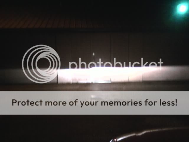

Have you or anybody you know of compared them to the Osram's? I have not directly compared them to the Osrams. However, I have compared them to an 85122+ here:
85122+:
Morimoto 5000K:
Secondly, how much brighter would you say the Moromoto are than the original bulbs? Not tons brighter. I have come to the conclusion that the optics of the projector, along with the lens are just not quite up to par with a luxury car. This is a disappointing revelation, IMHO

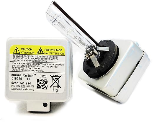

Thirdly, exactly what is the original bulb brand and model, and why would it be comparatively dim? I believe the OEM are Xenstarts. I have even found a pic of them:
