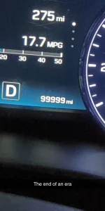

My Genesis just finally grew up into the big kids club. Having hit 100k miles on my car (owned it since 55k) I wanted to share my experience.
Happy as a clam overall. My passenger side creaks a little but my passenger side has been hit twice by other cars (not my fault and the doors were replaced - it is what it is. Side note: dashcams are worth thousands of dollars)
I've taken care of my engine to what I feel is responsible (full synthetic every 7k miles)
Replaced all coolant and trans fluid at about 65k. Didn't necessarily need to but the car was new to me and I was used to beaters that got neglected so having fresh fluid was important to me.
Things I've had to fix:
front parking sensors needed replacement just before 60k.
Replaced the third (in cabin) brake light at about 75 or 80k - the rubber strip had come off and light was intruding into cabin.
Replaced breaks and rotors at 95k
Replaced spark plugs and coils at 98k (nothing was wrong but I like to keep it that way.)
Starting at about 80k I did more research and saw I may need to spray the crc GDI cleaner into the proper area of the engine to remove buildup, and started doing that and noticed it helped keep the idling experience smooth.
I've gotten to 100k without knowing what my check engine light looks like 24/7, which is better than just about any other car I've owned. I loved the car the first time I saw it and the only reason I'd get rid of it is to get another, but I'm sure she's got another 100k in her until that day.
AMA!

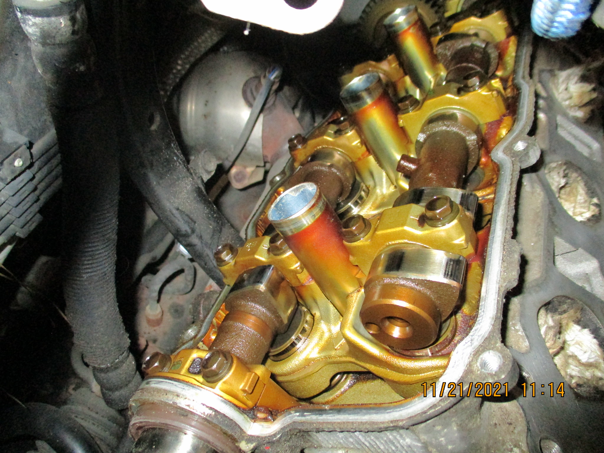

I admit that Toyota engines does seem to be long lasting engines by far. My 2007 engine with 226k miles purrs like it is a new engine. The engine only needed some new valve cover gaskets for a small oil leak.
My son's 2007 Toyota Highlander 3.3 V6 engine with 4-5k oil changes at 226k miles. Looks new on the inside. Change that oil by 5k miles regardless and the Genesis engines should look as clean at 200k miles.

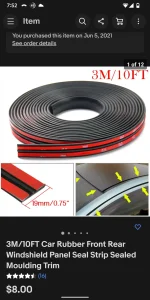

I would save yourself $475 and remove the hanging piece and use something like 3m seal strip to seal the gap like I did. You'll never notice it, nor will any back seat passengers.
