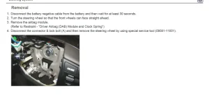

Does anyone have any links or write up on how to remove the steering and air bags off of a 2015 Sedan?
I just got a new CF Steering from G4 Werkz and I am going to be installing it soon. Any help would be appreciated.
