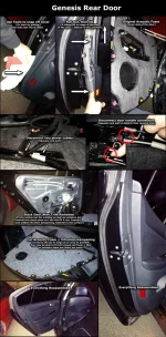

Hey there. In case you didn't figure it out, you need to remove the screw where the door handle is, a plastic screw in front of the door (towards the engine), remove the top plastic trim around the window, then pop off the door trim (there are multiple plastic clips). You might also want to disconnect the switch (2-3 plugs), 2 plugs for the door lock mechanism and speakers.

Unfortunately I only have photos from the rear door but it's a very similar process:
