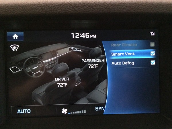

Yes - I believe that's correct as well. You can turn the feature off on the climate screen under the menu setting:
Looks like I have the non-functioning rear climate issue as well (greyed out). Damn, this car has more than it's share of issues - I will never buy a 1st year model again!
Is this a wide spread issue? I know I've looked at these options and remember my rear climate box being checked, but I also leave the rear vent on to help warm up the cabin a little faster (10 degrees F this morning). Does the rear vent need to be on to check or uncheck this box? I'd check myself but not near the car at the moment.
Nikgen
2,244
9
There have been several posts on this issue. I tried it with the vents both opened and closed, but the box remained greyed out.

I just went out to the car (G2 3.8 Ultimate RWD) and checked the function of the rear vent controls.
When the climate system is set to Auto, the rear vents seem to be automatically set to on. If, while in the Climate display, one pushes the button controlling the vent levels, upper, lower, both, then selects the on-screen menu the rear vent control should show and can be either checked or unchecked.
It appears that the rear vent selection will always show as unchecked if the Climate System is in the Auto mode.
Thanks - will check that out. Maybe not an issue for me after all. Other's have reported having a module changed to correct an issue with inoperative and greyed out rear controls.

On my European G2, the rear seats climate controls are manual. The temperature is adjusted with a potentiometer like the ones for opening and close the vents.On the potentiometer is from blue to red scale.
Rear controls box, I didn't saw it active until now..

I was one of the early ones to have the rear ventilation assembly switch replaced. I discovered it on a hot day when my rear passenger could not feel any air out of the rear console vents. I accessed the ventilation system menu and the rear vents were grayed out. I took it in and they replaced a switch in the console itself and it works fine now. The key is both "no air" no matter how dials were managed and the "graying" out of the rear vent system on the screen.
I noticed in mine that if both rear dials are turned all the way down the check box on the display will be greyed out. If it was unchecked at the time it won't be possible to enable it until the rear dials are moved from the down position.
I didn't test to see if it was actually one dial that controlled this, I was moving them both by reaching back from the front seat.
