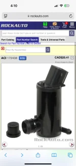

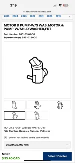

Washer fluid was leaking in my Genesis 2015 3.8l
The washer pump is hidden behind the liner. Removes the wheel, and remove the liner partially by removing 3 Philip head screws and 1-2 clips. You can unplug the white connector cable and pull the washer pump. Once the pump is removed clean the washer fluid and use brake cleaner to clean it properly from the outside. You can blow some air and see if it leaking from outside. In my case, it was leaking from outside. I just used think crazy fix and 5 min epoxy on the top and tried to blow air and no issues so far. Hyundai doesn't have the part for now. This is the temp fix I did for now see how long it will last. Rock Auto has the same part for 20$ and OEM from Hyundai it's for CAD 64 plus tax. Hope this helps.
