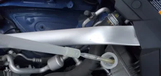

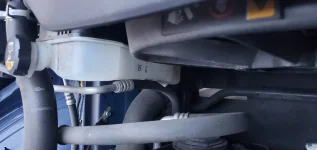

I would like to know which Engine Coolant I should use, I just noticed mine is almost empty on Reddit im told Pink google tells me Green and when I call Dealer he tells me to drive over...
I have 2019 2.0T AWD G70
Thank you for your help.
P.S - I would like to know which brand should I get also I would prefer the diluted one to not mess things up.

Get the same color that you have now, preferably. And I'd buy it from the dealer. Just bought the OEM pink coolant from a dealer for both my '23 G70 and '22 SF Calligraphy (that's what both have), and it wasn't 50/50, so pay attention to that. It has to be diluted 50/50 with distilled water. Older vehicles have either green or blue, so check out which one. I think the blue comes in 50/50. You could buy aftermarket too, but make sure it's long life, to be compatible.
