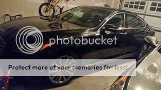

So, one week later and still driving the loaner. 2015 5.0 Ultimate. Caspian black and black interior. Nice car. Love the interior, exterior is staring to warm me over, BUT i want and miss MY R-spec.

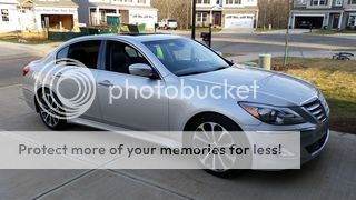

Well, got my baby back. Car shifts amazing and I am glad to have her back.
