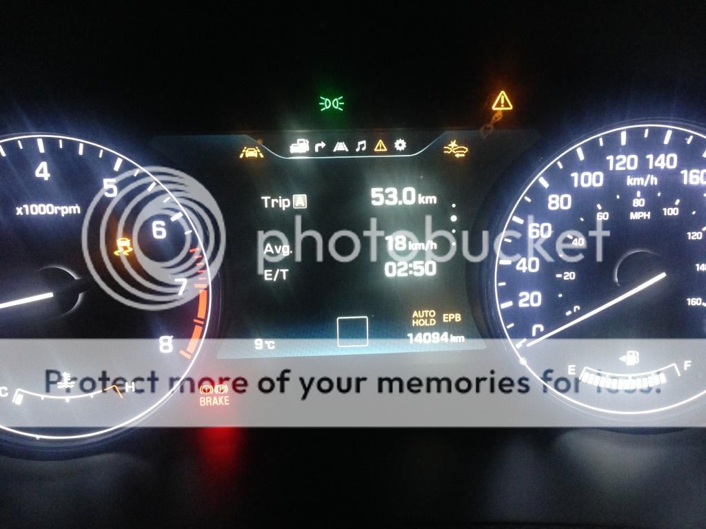

Over the last couple of weeks, I had an issue when I would shift into gear from time to time. Once I shifted into "Drive", the following warnings would appear on the picture below. (Notice the "D" is missing)
Brought it into the dealership and they had stated there was an issue with the inhibitor switch and the part had to be ordered and would take a week to arrive. The work was completed today and so far so good. Will be watching this over the next several days.
This was listed as TSB 14-40-007. Did a few searches with no luck on any more details. Wanted to keep everyone informed just in case they run into the same problem.
