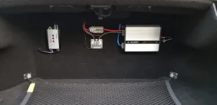

My setup.

My box sits about flush with the silver net hooks on the inside end. I am happy with how my box is located. The bass response is very very strong since the rear of the trunk provide a place for the bass waves to reverberate from.
Plus, I like how my set up look as is since it hides my amp and wires.

20190906_192427 - Copy.jpg 20190906_192427 - Copy.jpg 20190906_192342 - Copy.jpg

The icing on the cake for me was I found a speaker grille for a 6" in-wall laying around the house that fits the opening of the ski boot almost perfectly! Painted it to match the trim around the hole and used just a bit of gasket on the top and bottom to keep it in tight. The whole thing is tight and right and never has needed an adjustment. Rounded out the frequency response to my liking (y)
View attachment 22995 View attachment 22995 View attachment 22994

Thanks! It took some time with a cardboard template to get that amp rack plate to fit just right. 500 watts RMS @ 4ohms works out well for that IDQ in about 1.1 cu/ft. The whole of the system is loud enough for my older ears, I'm sure it's not a 115db + system but probably in the mid 100s with low distortion. Certainly enough quality db though I wish I could have tapped a true line level feed rather than going with a line converter from the existing sub speaker level out. Seems to suffer a tad in the damping factor that way to my ears.
