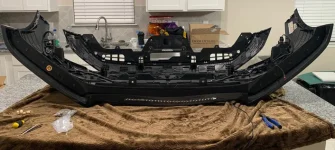

So tonight I only did the Intercooler and front Underglow piece because to do the intercooler I had to remove the bumper and the front Underglow I would have to remove it again later so I just did them both at the same time. I also plugged them both into the LitKits Bluetooth to at least be able to use them and check if the Underglow works until this weekend when I can install the rest and I would just need to move the plug as all the wiring is done.
So one think I did was order LED Strip clamps you see on the underglow part. They are clear and screw into the CF lip. I then drilled the CF and the soft foam and plastic to run the wire up into the bumper and up the same path as the LitKit wiring.
I am a little disappointed that the front and rear Underglow strips are only 50CM. I am going to ask Diode Dynamics if it is possible to have them make me a custom strip that the wire is in the center and the strip is as wide as the front of the car. It is just not wide enough and I am not sure if it would look better if it was much wider like near the tires. Just seems so short as you see in the photos.
They can just put the power wire in the center and I can pull the wire out by giving it slack from the top likely change it and pull it back up. I am tired of taking the bumper off LOL I have taken it off 4 times now and well it gets old.
I am lucky that I can drill into the CF with those little clear clampos and they are very secure and I can do this down the whole sides and rear. I am excited to get the lighting up inside the diffuser too. I think it will look amazing.
