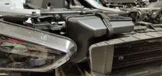

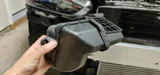

Got a response back from Agency Power, they told me that they tested their Stinger intake on the G70 and it fit without any problems.
The intake snorkels, on the other hand, will not fit our cars since we have some active aero for the radiator.
In fact, looking at the stock intake design, you can see a fair amount of restriction due to the snorkel routing. If you removed some of the snorkel you would probably remove some of that restriction. This part is what I'm talking about...
19961
19962
I actually emailed Velossa Tech about their snorkels, and Dan told me he might be able to design a set for the G70, hence why I removed my bumper. But after I got it all off I'm really beginning to doubt that it's even possible. Oh well.
Either way, AP intake for me!
Thanks for the investigation and info. So are you saying you are going to leave the intake part off?
