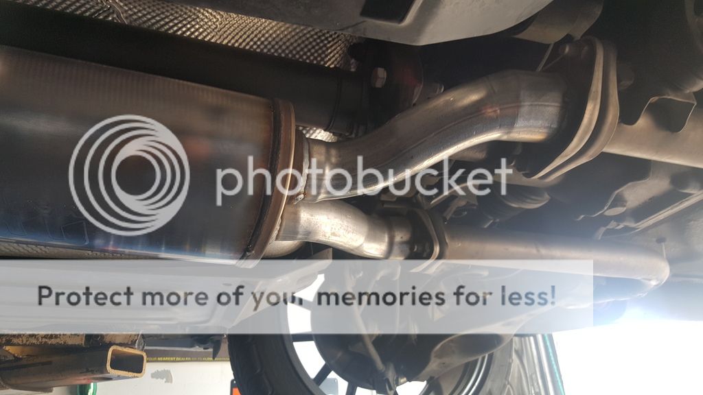

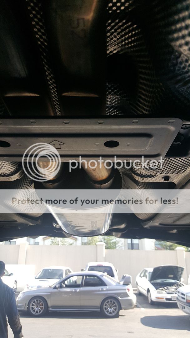

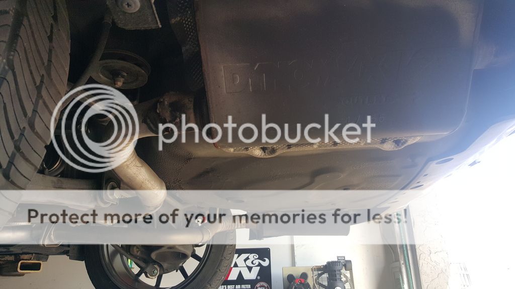

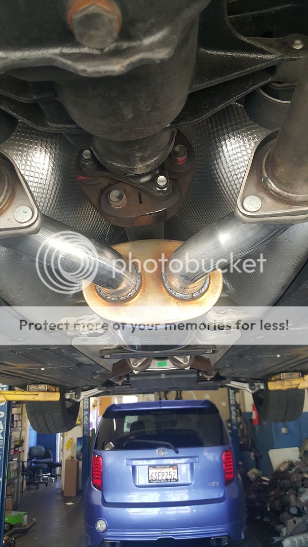

Got my Magnaflow 12468 installed in place of the center resonator on Saturday. Based on other sound clips I've heard of other cars I thought this might make it slightly louder and meaner without going overboard... I was totally wrong. Installed in front of the Dynomax VTs it actually quieted down the exhaust note almost back to stock! Outside still sounds better than stock but inside you can hear almost nothing except the engine in front.
All in all I'm very disappointed and have decided to just install a standard x-pipe in place of this. If you had some other louder mufflers in the rear such as a standard Magnaflow or similar this setup would probably sound great and would be a drone free alternative to the VT. With the Dynomax VT though it's just too quiet and too similar to stock.
Here are pics of the setup:
As a side note: I would not recommend installing this if you're lowered as it hangs down an additional inch or so. I'm stock height and don't ever plan to lower so it wasn't an issue for me.

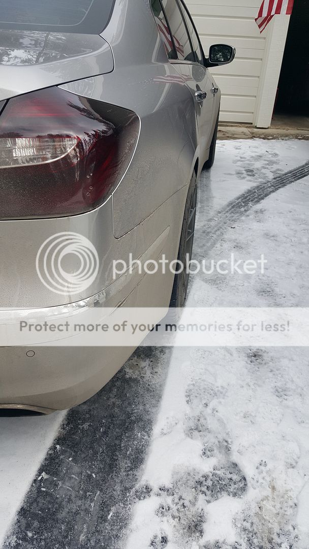

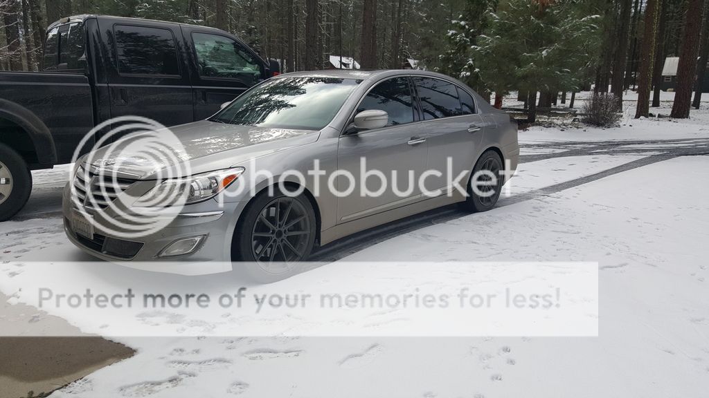

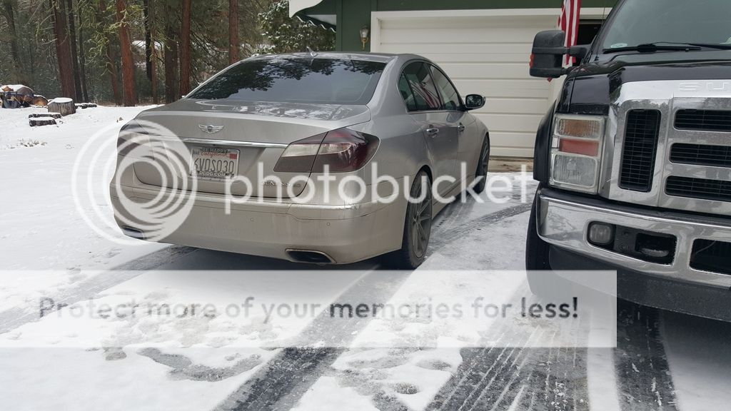

Here are some updated pics of the fitment. They are (obviously) not very clean here, but the fitment is damn nice.
Looks good! I'm surprised how clean the underside looks considering you have snow there. I guess your city doesn't throw salt all over the place like here.
Actually the underbody pics were from before I took it to the snow. Where I actually live we don't get snow -- those were taken up at my grandparents' house about 200 miles away. CA does not use salt on the roads, however.

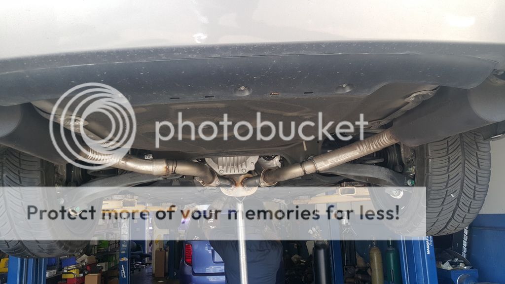

So I cut out the Magnaflow X-Pipe muffler and welded in a regular X-Pipe in its place -- WOW. It sounds perfect! Absolutely no drone on the highway and gets super aggressive above about 3000 RPM.
I think the perfect, not-too-loud exhaust system for the 5.0 is:
Magnaflow X-Pipe in place of the suitcase resonator
Dynomax VT Mufflers at the rear
And that's it. I may try the MSA cat-deletes but I'm not sure I want it any louder and I'm sure there's almost no performance benefit to be had there.
