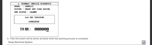

Unless of course I am misunderstanding and we're talking about saving PINs for the smart key fobs, in which case the relevant pages are below... all of this any mechanic should have available in their service data. So if your mechanic can't figure out how to swap an IPM, it might be time to find a new mechanic who knows the process and has a GDS with a live connection (e.g. a dealer).
